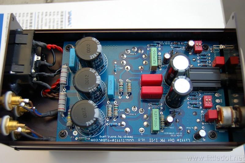

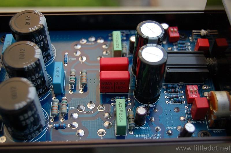

The Little Dot MK II is a SEPP (single-ended push pull) OTL circuit operating in Class-A. The high voltage swing is ideal for powering high impedance headphones with plenty of headroom and dynamic impact along with a touch of tube warmth and tonal richness.

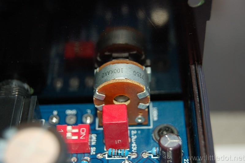

While the Little Dot MK II shines best with high impedance cans, it also offers versatility with multiple gain settings of 3, 5, and 10 via internal DIP switches for fine-tuning so you can maximize synergy with almost any headphone you have, whether it be 32 ohms or 600!

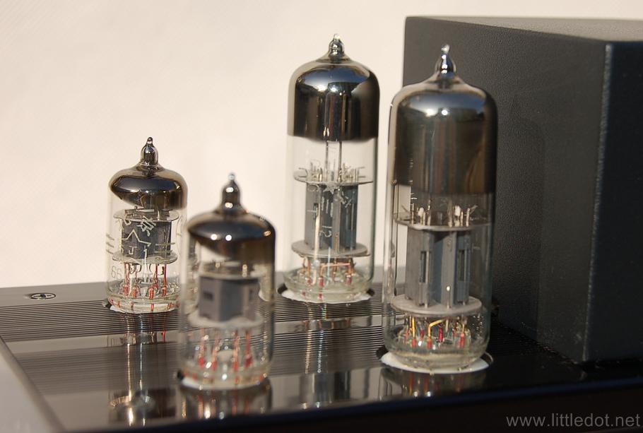

The Little Dot MK II also gains the driver tube-rolling options from the rest of the MK-series with the ability to roll 6JI, WE403A/B, GE5654, M8100, CV4010, EF95, etc at its factory jumper setting, and with jumper pins shorted, EF92, CV131, and all equivalents and drop-in replacements!

  • Driver Tubes: 6JI
  • Power Tubes: 6N6
